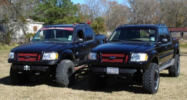

I really don't have a TT now. I advise against the TT nowadays. Yeah, I did it in the beginning. Right now on my truck, one side is cranked up and one isn't just to kind of make both sides at the same level. Obviously one of my torsion bars is more fatigue than the other. I have a side by side pic of Txplates and my truck after he put on his 35" MTRs. Txplates never did a TT and his truck's(no offroading experience) front end looked higher than mine. And my torsion bolts were cranked all the way up.
My truck is on the left and Txplates is on the right. My truck is after years of abusive offroading. Txplates truck had not been offroad yet.
