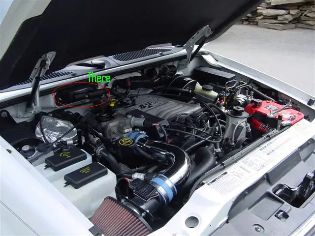

i need to tap into the the speed detection circuit lead for an installation of a nav system where is the the ECU located and what wire is the speed detection circuit... any help is much appreciated...
Self explanitory
thanks a lot will check it out... just wondering which wire is the speed detection circuit..
I'll take a gander through my chiltons and haynes.
According to the Haynes its a Gray/Black(GY/BK) wire. Pin 58.
thanks a lot, very helpful... all installed and looks good so far...
