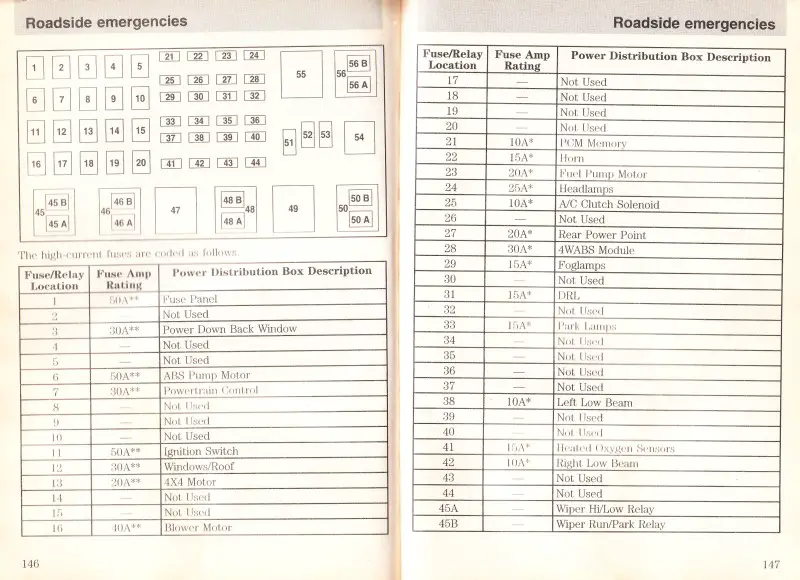

On my 01 ST I can reset the computer with no tools required.
On the Power Distribution box underneath the hood, pulling fuse #21 will clear the computer's memory and codes. Sadly, this trick does not exist on my 2000 Explorer Limited.
