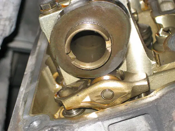

The instructions with the timing kit are for installing the tools. I agree that they are not very detailed. They don't include timing instructions. If the camshaft holding tool is installed with the timing slot above the axis of the camshaft instead of below the axis (correct orientation shown below) the holder may break.
I followed all instructions to the absolute letter. 6 hours later I turn the key and well something obviously wasn't right. Crank crank crank crank crank crank .... and BARELY starts and NO power. Ok both cranks must be 180* out. I tear back into it a few days later and spin both cranks 180 degrees, put everything back together. Same sh*t. Crank crank crank crank crank crank .... and BARELY starts and NO power.
If you spin both camshafts the same amount nothing associated with the timing will change. If one camshaft was 180 degrees out from the other and you spun both 180 degrees then the camshafts were still 180 degrees out. The left camshaft timing nub (blue arrow in above photo) notifies the PCM via the camshaft position sensor when the camshaft is on the compression stroke for cylinder #1 . If the camshafts are 180 degrees out with each other then the injectors will fire at the wrong time.
