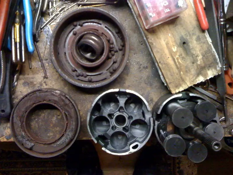

Look up the FS10 compressor. It's a 5 piston compressor. Stupid that Ford would use it with Scroll compressors available...
Here:

First, I thought this was an axial piston pump. So, you're saying the gizmo above can't seize up? If I recall correctly my '04 has an F-10, replaced one several years ago, but can't recall what vehicle. Nice illustration you provided!
Geez, Joe! Could'ja at least have shown one that wasn't destroyed? :D
Well why would one take a part and show pics of a perfectly good one? hahaha
That compressor looks just a but shot lol
