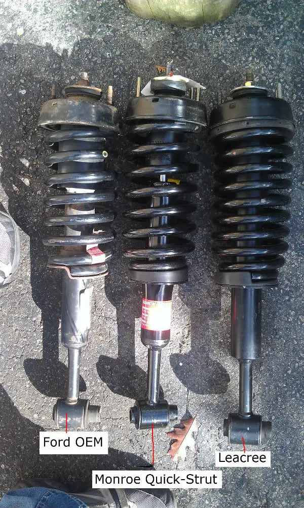

you would have to redo everything up front to run stock 02 (3rd gen) coil over struts. they have a strut mount.
Here's a pic to show what I'm talking about. they wont mount to your existing hoop mount. if you knew that already sorry. just figured I'd give an opinion
Now if you still have torsion bars you could take the Fox shocks off and install other cheaper after market shocks (that are for a 2 inch lift and add spacer to the shock mounting area to make u for the size of the fox shocks eyelet if needed) to your existing shock hoop and just back the torsion bar bolts down some to lower the vehicle. that is if your truck is still running torsion bars.
