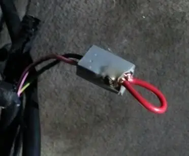

I think I found my issue. The connector to my inertia switch is melted. I checked it before, but never pulled out the connector. No idea why it would have melted.
So until I get a new plug and inertia switch, I just shorted the connection with a wire. Hopefully I won't roll it over or get into an accident in the meantime.
So a 50cent part has cost about $700. I've taken it to ford dealer twice, midas once, replaced the fuel pump and a ton of sensors, etc... Some stuff needed to be replaced anyways, but I spent about $300 at ford and midas having them trying to diagnose the problem.
Before I had just pulled the cover off and checked the connection, but never removed it ... stupid me ...
