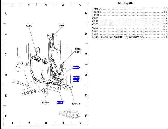

Welcome to the site. Couple of questions, when you turn the key to the ON Position, can you hear the fuel pump? If not, then there is your problem, the fuel pump is not working. There is a fuel shutoff switch on the passengers side firewall (well on the 1st gen & 2nd gens not sure on the 02-current). You can also check for fuel pressure by pressing the schrader valve on the fuel rail but wear glasses when doing this to avoid gas in your eyes. If all of those are fine, then also check for spark.
Look underneath on the passenger side back by the center console. Thats where it should be.If not try by the drivers side up by the pedals in there. Hope this helped a little. But usally the switch turns off if u get in a acident. Maybe someone kicked it by mistake.

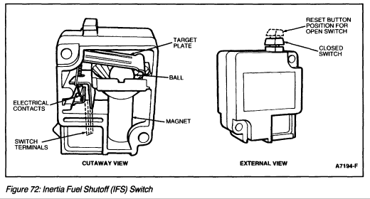

The Inertia Fuel Shutoff (IFS) switch (Figure 72) is used in conjunction with the electric fuel pump. The purpose of the IFS switch is to shut off the fuel pump if a collision occurs. It consists of a steel ball held in place by a magnet. When a sharp impact occurs, the ball breaks loose from the magnet, rolls up a conical ramp and strikes a target plate which opens the electrical contacts of the switch and shuts off the electric fuel pump. Once the switch is open, it must be manually reset before restarting the vehicle. Refer to the Owner Guide for the location of the IFS.

Exploded, your memory was perfect! If nothing else, now I'll have the manual in pdf-format for future reference & can use the ~$20 I'd have spent to order a manual toward fixing this pig. Oh, & it was here that I discovered just how big a Polak I am (I am, so figure I can say that w/out offending): shut-off's right inside the door of passenger's well & the opening to reach is designated w/ raised lettering on the molded part that calls it out!!! Alas, it didn't help. But, 1 more possibility eliminated.
David, the schematics helped to understand the mechanism.
