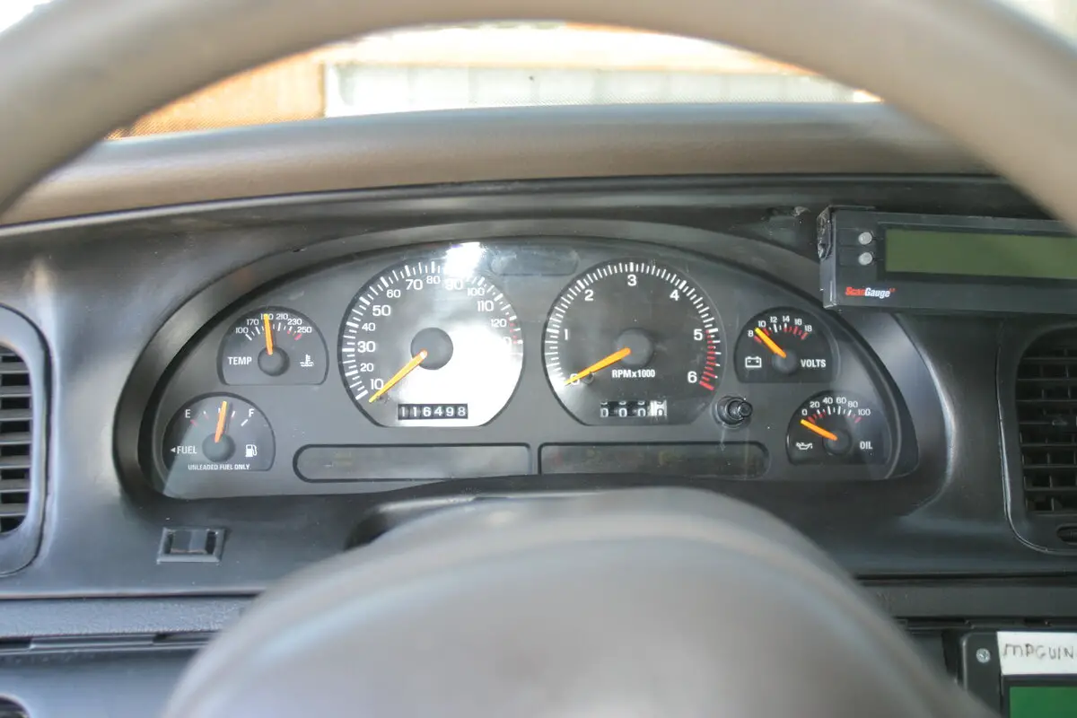

I work on a few clusters, and swapped a 98 Mustang Cluster into a 2000 Mercury Grand Marques, and will be putting it into a 03 Crown Vic and could do so with a 04. AS these were the years of the Mercury Marauder's which gauge cluster were backward comparable to 1996 Vic and Mercury's.
This is my custom cluster in my 2000 Mercury.
Note only the speedo and tach have resting stops.
