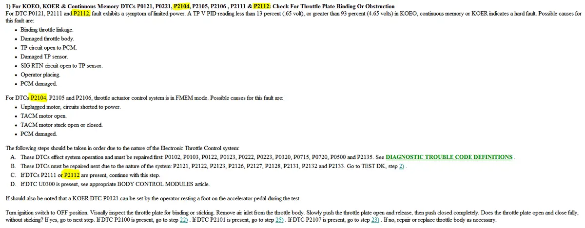

I happened to notice that my battery cables were pretty crusty on my 2004 Explorer with the 4.0 motor. I pulled them off to clean them today. I regret it. The truck was running great but now it will start but barely run at all. The wrench light is on so it seems to be in safe mode? I removed the negative cable and let it sit for 1/2 hour and it still does the same thing. I used my code reader and have codes p2104 and p2112. I saw another post where someone says to clear the PCM's memory by using jumper wires negative to positive. Here is a video. Would that help? I have cleared the codes with my reader already but it made no difference. Should I do it like in the video? What else can I do? Very frustrating to be able to mess up a perfectly good running vehicle just by cleaning the cables!! Thank you for any help.

Well the the jumper reset did not make any difference. I followed the instructions as in the video. I tuned the key on and waited 10 seconds a couple times. Started the truck and same thing. In fail safe mode! What do I need to do here? Should I go about cleaning the throttle body? Ahhhh what a mess! Oh and I am not touching the pedal when starting.
I did the the jumper reset at least 5 or 6 times and tried various things like turning the key on and waiting 60 seconds, clearing the codes with my obd reader, turning on AC, pressing the pedal etc. etc. Finally on what I swear was my last attempt before removing and cleaning the throttle body it fired right up with no issues at all just like before. I took it for a decent drive and no problems. I did clear the codes with my reader right before starting it when it decided to work but I think it may have just fixed itself after a while? Hopefully I will be good now as there really was nothing wrong with the truck prior to removing the cables. What an ordeal. Someone at Ford should be hunted down and smacked for this one!
