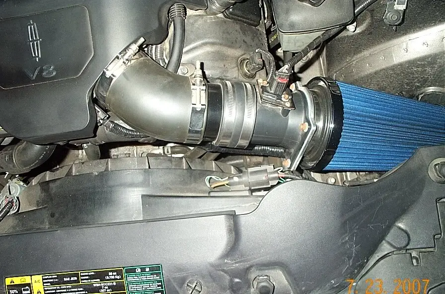

You have a few options available to you to use this stuff you do have. First off you could buy a stock old style MAF, take the guts out and make an adapter plate (with gaskets) to allow your slot-in meter to bolt into the housing. Then you could use those parts with it just fine. I will attach a picture below of what I am talking about. Pretty much with a Dremel tool, drill with bits, tap/die set, and some flat steel stock from Ace or Home Depot and some Auto Zone make-a-gasket sheeting you can do this.

when i saw the way this airbox was put together, i was suprised at how the MAF sensor is in one piece along with the airbox... if it was separated by screws, then this adapter piece would fit fine...i fabricated my own with the stock airbox screws.. excuse the dirtiness... old pic
