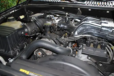

Well, I did it this afternoon.
Gasket with washers
Engine Compartment:

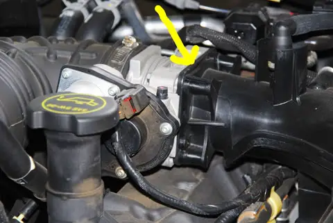

Close up of the throttle body:
The yellow arrow points to the toothy thing that has to go.
Take a screwdriver and pop the hose loose.

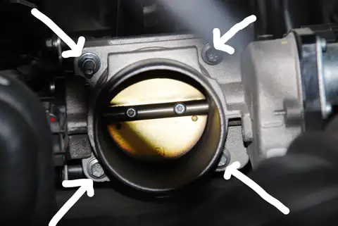

Then, using an 8mm socket, carefully remove the four bolts below:
The upper left one needs either a deep well or a wrench. Be careful, those things are screwed into plastic.....

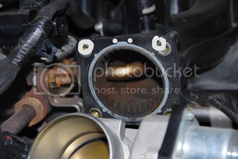

Once the throat is unscrewed, you'll see something like this:
I got bored and drew a face on it. It just falls off. Clean carefully the mating surfaces, apply the new paper gasket and then screw the bolts back on. Here is where I had an issue - none of the washers I bought fit. Duh. So, I didn't want to go back to the store. I noticed the toothy thing has metal inserts for the plate. I popped them out, and voila - washers.
Dunno how it will work long run, but I drove it around town, and they didn't loosen. I did absolutely notice a difference in the bottom end. And much less hesitation where I had serious tip in issues earlier. Butt-dyno reflects moderate gains in RWHP... lol Thanks cornburner!
