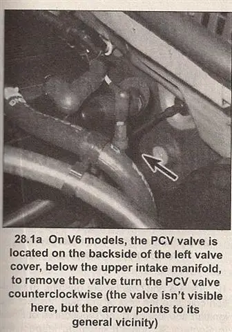

Hello all do you know what the PCV value is located on a 4.0 '04 Explorer?
I checked the How To section but not came up with the key work PCV.
Thanks in advance.
It should be in driver side valve cover in the back almost under the intake manifold.
From my Haynes Manual:
