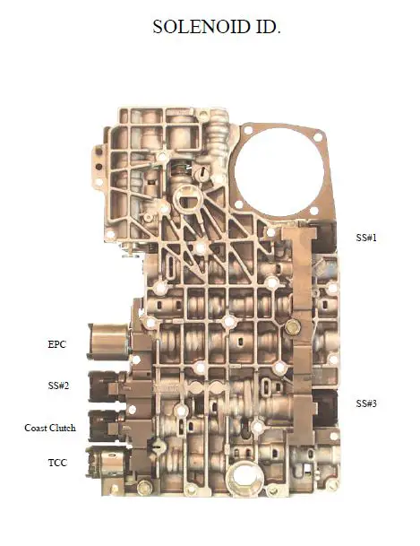

The TCC solenoid on the 5R55E transmission can fail and cause the converter to engage when selecting drive.
Its fairly easy to replace once you get the pan off.
If it still happens after the solenoid replacement the next thing to look at is the converter clutch shift valve in the valve body, (its the valve that the solenoid controls), if its stuck it can cause this too.
You might be able to move the valve with a pick when the solenoid is out because it is directly behind it.
