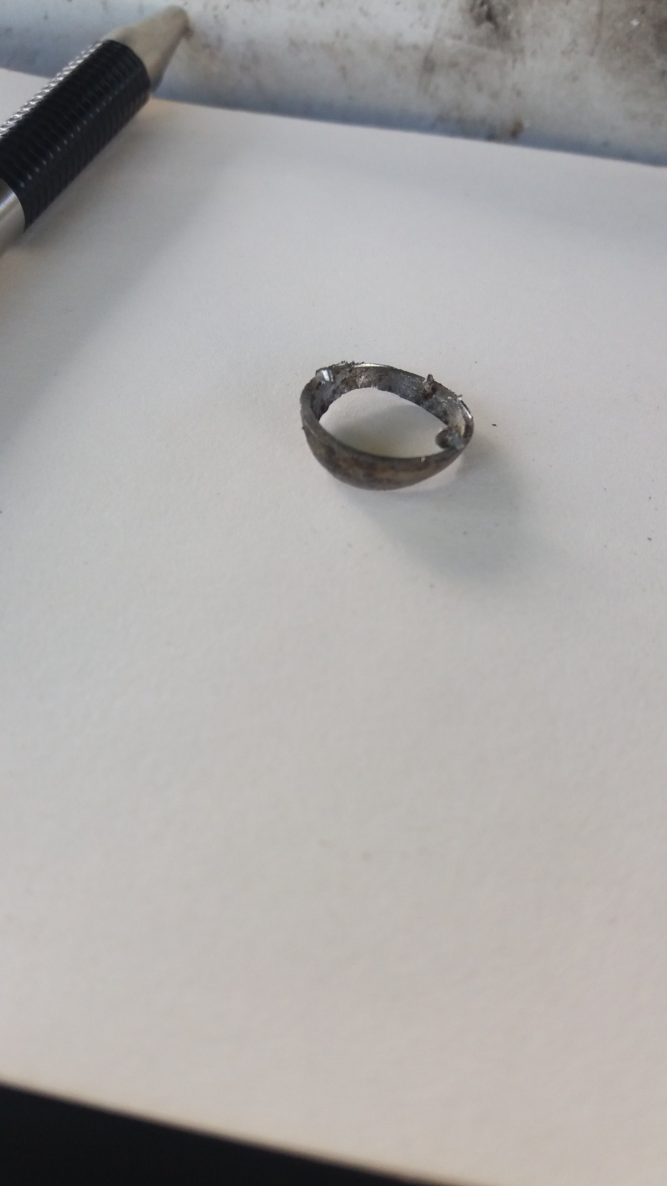

The last piece at the bottom of the larger diameter metal section of the old plug came out after using the tap (pictured). The new plug has threaded all the way in - at least I'm trying to verify that now. If it's not all the way in, it's only by one revolution or less. I've pulled the adjacent plug to visually compare the two sets of threads. It appears as though, after tapping, a low part of the thread wall is missing.
Not sure why, but I'm hesitant to put those two plugs in, put everything back together, and fire it up. Probably hesitant because each accomplishment has beem followed by a setback in the last 10 days. Where's my tissues...
Anyway, two things: 1) printed on the autolite ht1 box, it says, quote " The new plugs should be installed with no anti-seize lubricant on the threads", the box also says to coat the ground sheild and motor seat with a thin coat of anti-seize. 2) I've only begun to research the helicoil issue - trying to cover my bases in case the plug in the hole I just tapped blows out. Any thoughts on the no-anti-seize-on-the-threads from autolite, and also is anyone familar with the helicoil set or kit specific to the 3valve, in case the new plug blows out? As always, thanks again
