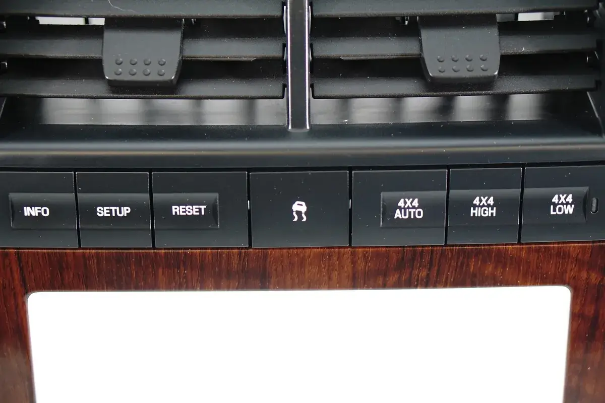

You picked up the wrong instrument cluster for your vehicle. Your needs the cluster with the smaller two line center display. This is indicated by the three blank buttons on the left of the 4x4 and traction control buttons. For the display you show above there needs to be Info, Setup and Reset buttons in this location. Maybe you can get these button at a salvage yard and install them if there is a connector at the location for the buttons. The again, maybe these options need to be programmed into the computer system of your vehicle to work properly.
