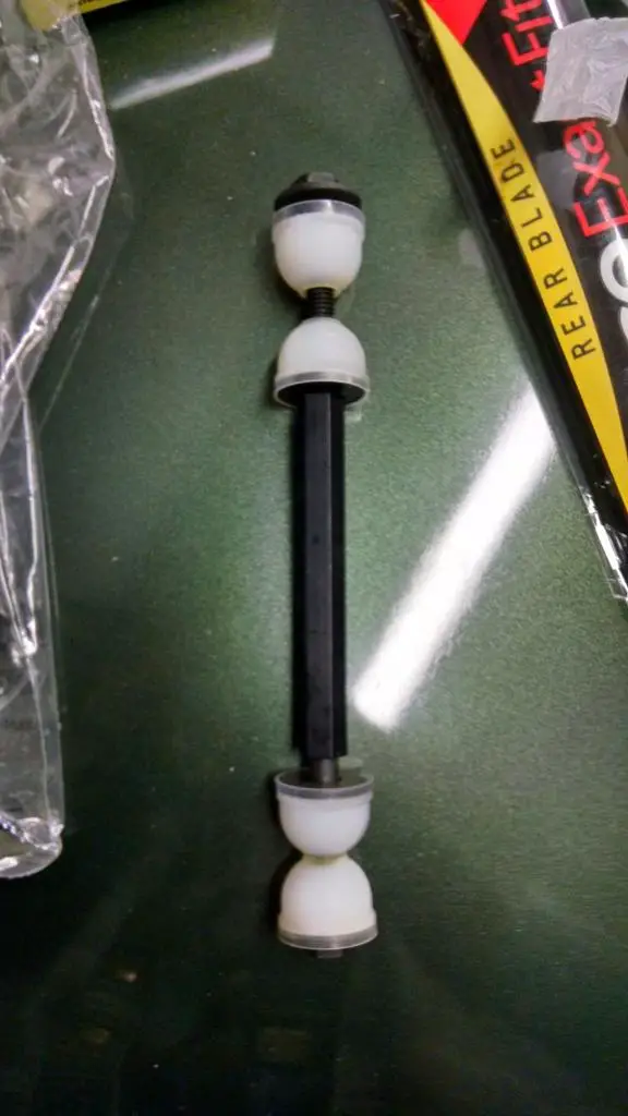

Here is the replacement part I got from Advance Auto:
From what I gather, the bolt broke. I can feel the head of a bolt on the bottom side. Question: Does the thread coupler that came with the new link setup replace the hourglass thing on the axle? Or is this piece attached to the axle and the threaded coupler goes up through it?
I'm not sure what's holding this hour glass shaped piece to the axle. Perhaps what's left of the bolt itself?
So once I remove what's left of the bolt, I assume the hourglass piece falls off and I use the thread coupler that came with the new link setup? Or what?
I replaced all 4 of my endlinks last year with those polyurethane Moogs, as 3 of mine were broken. Yes, the hourglass thing (called a "spacer") gets thrown in the trash. The new hexagonal spacer that came with the Moog kit is it's replacement.

The new parts I got from Advance Auto contains four bushings. I'm only seeing two bushings on the opposite side (that has not broken). Where do the other two bushings in this kit go?
There is what looks like a pipe cap below the hourglass shaped thing. Is that a bushing? Does the other bushing go underneath the axle and I just can't see it?
Or did the guy give me the parts the secure the swaybar to the body or frame that I cannot see?

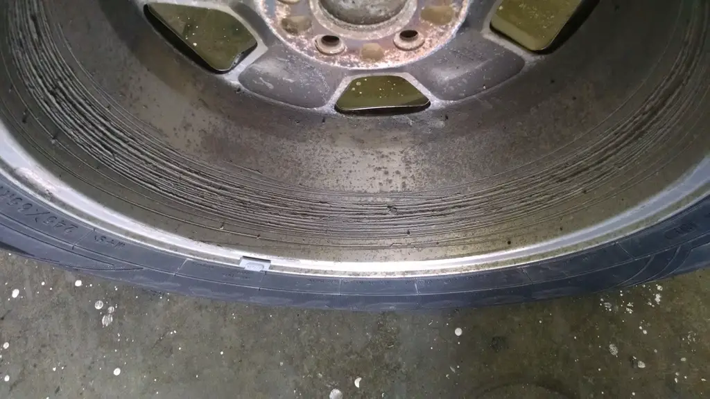

I noticed these gouge marks in the wheel. I don't think they were caused by the loose swaybar. They look rather old. What could have caused this to happen?
