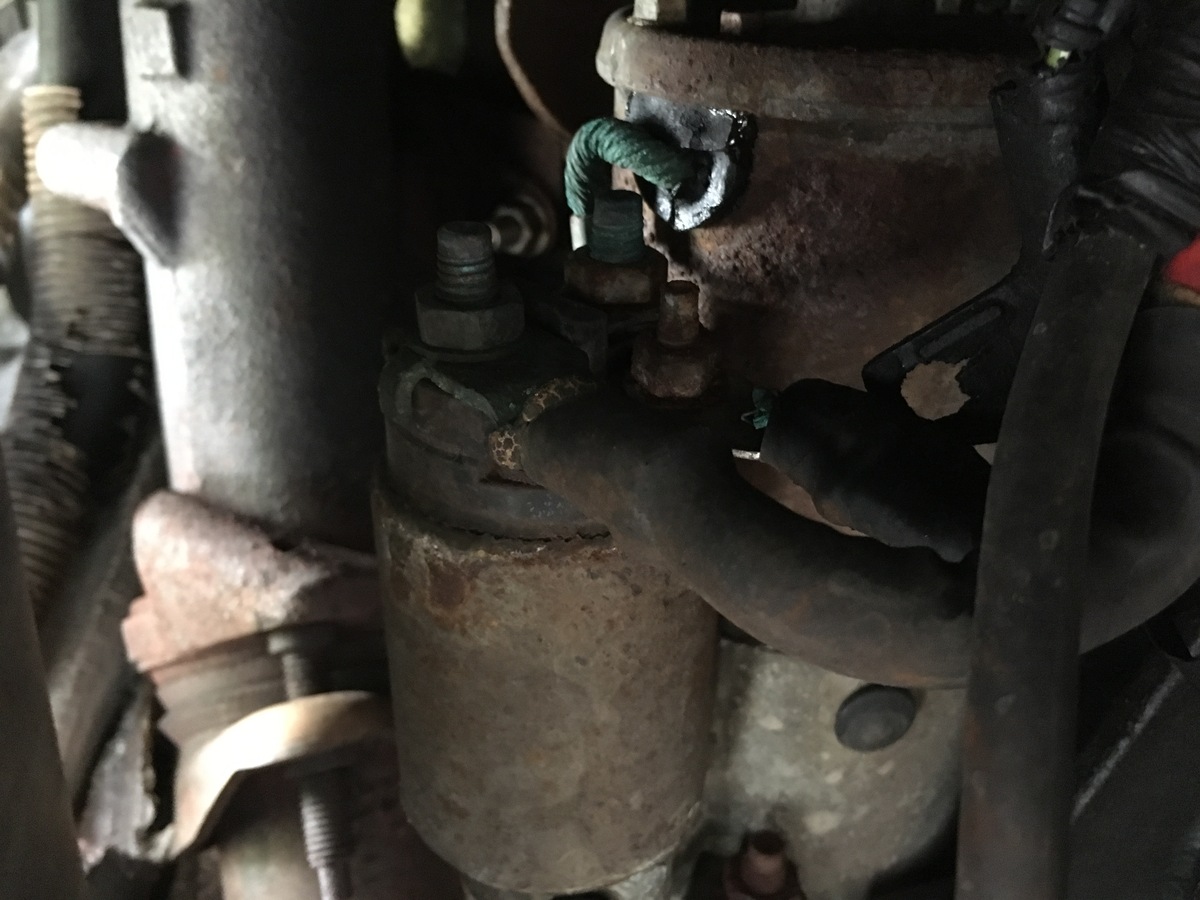

Old starter still in the car:
Old and new
Back of the transmission, I think the picture is rotated:
The fixed positive stud
What worked between the top bolt and the engine mount:
shallow socket and 1.5 wibble extention.
Now, when I look at the pictures, am I missing a manifold flange bolt ......?
If one photo was taken from above and another was taken from below then it sure looks that way. The stud appears to be broken?
