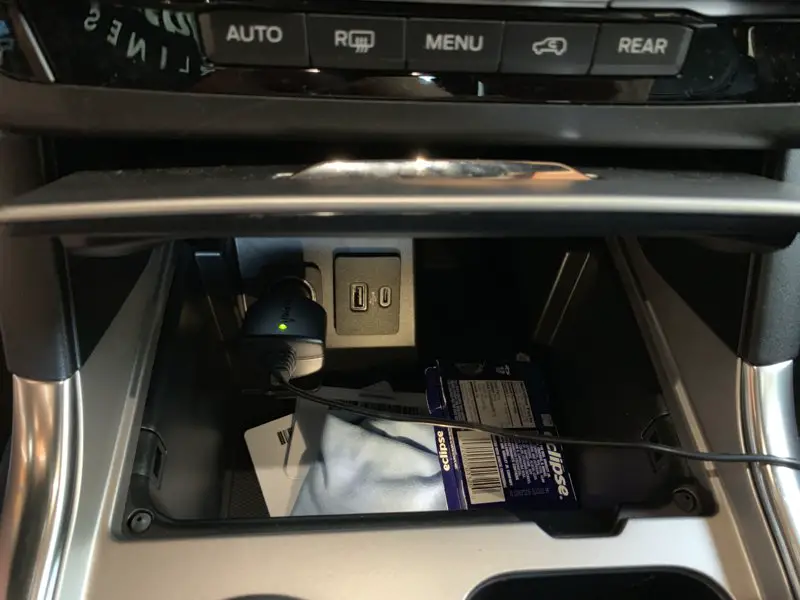

I just installed my dash cam and have it plugged into the 12v lighter socket in the front forward covered console. I noticed that it is hot wired and won’t turn off with the engine so my camera stays on 24/7. Before I attempt to rewire everything, does anyone know if the one on the center armrest also stays on 24/7 or does that one turn off with the engine? Thanks!
Wish they'd make up their minds. It seem that every Explorer I've had is different. 2004 stayed on 24/7, my 2016 Platinum shut down with the key...for awhile...now it stays on...go figure. Ford dealer assured me that the 2016 shut off with the key but even after demonstrating that he was wrong he wouldn't believe me. The shop couldn't change it so now I have to be careful what I leave plugged in.

I’m gonna check. I was proud of myself for completely concealing the wire but just checked the armrest one and that stays on 24/7 as well. Dammit!

Pretty sure it times out and shuts off after 20 min. There is a setting in forscan for the battery saver time out. People on the Superduty forum were changing it to max out at 3 or 4 hours (I think 3 was the max) due to wanting accessory power longer.
