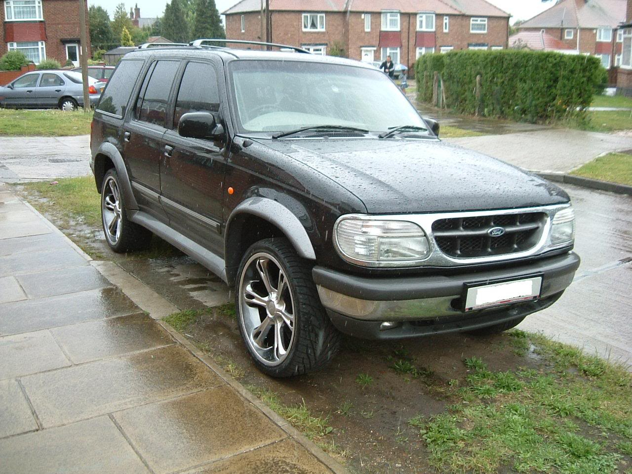

I have 22"s on and the car handles 100% better than with stock wheels, less roll in corners due to less tyre wall flex, more grip etc.....the list is endless.
Still trying to source some damn spacers though !! :mad:
