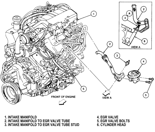

No EGRs on 91s; that started on some 93s.
sorry not a 1991 but a 1992 explorer not sure the egr is the problem any help would be great nee a the input I can get
Welcome to Explorer Forum! Have you checked your plug wires?
No EGRs on 91s; that started in 92.
My mistake, after some research the EGRs first went on the Cali models in 1993. There was no EGR on the 91s and 92s near as I can tell (I have a 91). Anyone with a 92 that's different, say something and I'll stand corrected.
For those still looking, a pic (courtesy Dogfriend) below.
Sorry for the confusion.
