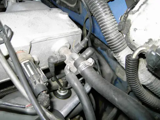

With that hissing noise, I think I would start by looking for a vacuum leak.
From a vaccum standpoint, you're looking at the vacuum tree on the driver's side, on the rear of the valve cover. Follow the lines and ensure they are connected. A problem failure is the big hose going to the right that goes into the brake booster. The grommet breaks real easy and lets the air in.

i had that same problem its on your break booster if you turn it on you can hear it with your hood up and can feel it it sucks some major air. and the plus to it, it only cost like six bucks. and its not bad to replace at all. on mine it wasnt the grommet it was like a plastic cap that had broke off and it looks like crossheirs with that cap broke off.

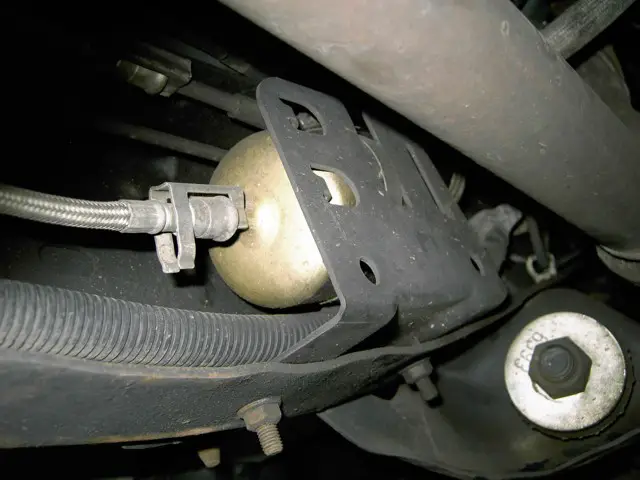

can someone tell where my fuel filters is on a 1991 ford expolrer and how to change it?
on the drivers side of t he car, underneath. kind of sitting on the frame rail i guess. its behind this metal cover thing. y ou gotta take that off, then u need a special fuel line tool to get the lines off.
Aft looking forward, driver's side. You'll need the special fuel connector tools. These can be loaned from autozone.
