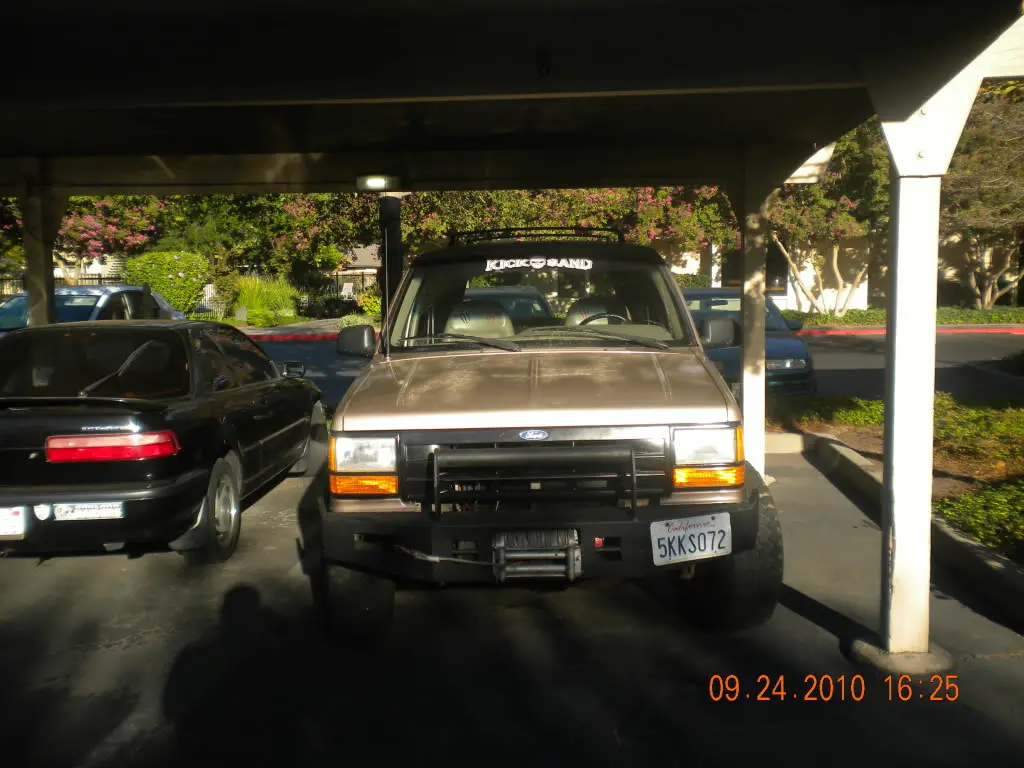

i just put the frount bumper on this weekend. im looking for a back one now. I have a back on for a 87 ranger and it does not fit on the X.
