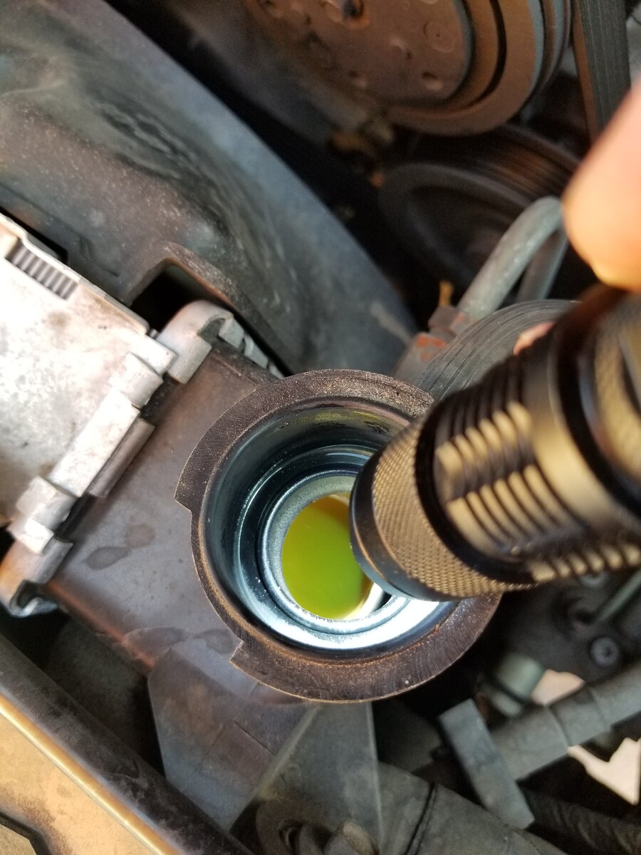

My 1993 Ford Explorer XLT gets hot when idling. Hot enough that the AC stops. The temp gauge doesn't peg out, but goes up to 3/4 maybe. Once I start moving the temp drops back down and the AC starts up again. No issues at all moving at 75mph on the interstate, just at red lights or sitting in a parking lot. I could be wrong, but that seems to be an airflow issue.
I have replaced the radiator, engine cooling fan clutch, and the thermostat. The new engine cooling fan is spinning and appears to be working properly.
Any ideas on how to correct this issue?
Edit - I did the water pump too. The coolant looks good, and the radiator and condenser look reasonably clean still. This has been an issue with the vehicle since I've owned it, it's not something that just started.

In your pic I can tell you have a two row. It's basically the thick heavy duty radiator. The single row is half as thick.
This is valuable information, thank you. I was working from my phone yesterday and couldn't find much on how to tell the difference.
