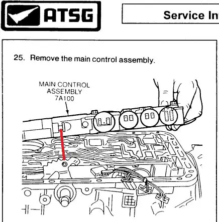

Sounds like the lever does not match the notch of the main valve of the valve body.
Could happen when installing the valve body.
