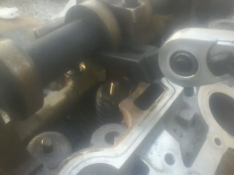

Today after working with 3 different spring compressors to remove the keepers to get the valves and vs seals out and in I settled on the only tool that would work well and eventually on all six valves. I replaced the 3 exhaust valves and all 6 vs seals.
The tool below is what I was using. I had to clearance this one particular spot in the casting for the tool to work on the 3rd valve.

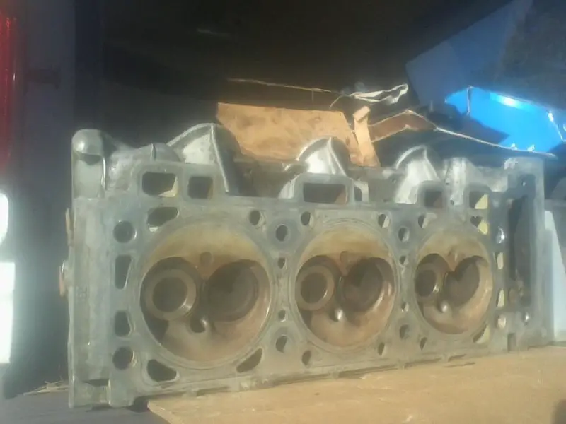

I had to attach the head to a board to fill in the gap between the valve top and where the head fastens to the short block. The tool was pushing the valve down too making it very difficult to remove the keepers. Also it was handy to have it attached to the board to keep the head from moving around. I used 4 of the old head bolts.
It's kind of hard to see the board in the last pic. Here is another picture.

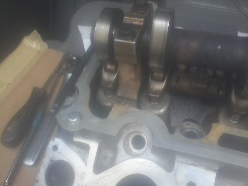

@koda2000 Yes there was a little flash rust on the cam but mostly some oil residue. A little bit of emery cloth cleaned it up in 2 or 3 minutes.
The rocker arm/followers got installed. The cam caps were torqued to their spec before installing them.

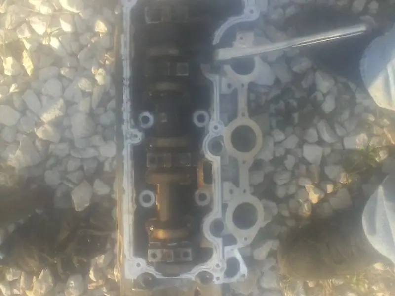

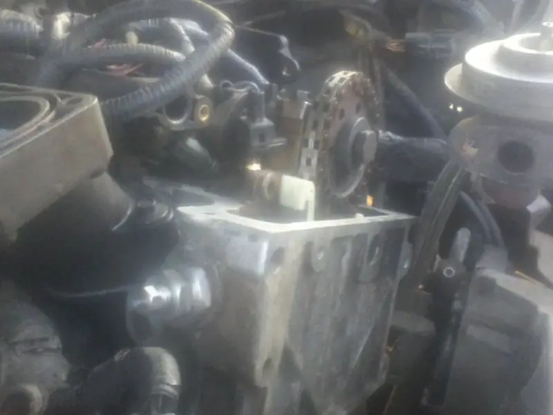

Now I'm working with the timing and I have noticed that when the cam is parallel to the plane of the head the cam sensor nub is not quite perpendicular to the plane of the head, that is the surface that the valve cover bolts to.
QUESTION-Has anyone that has had one of these 4.0 SOHC engines noticed this?

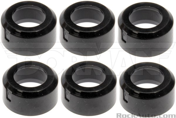

Sunday afternoon I was ready to install what DORMAN refers too as Fuel Injector Sleeves. These will not work. They are a hard plastic piece that doesn't have any give to them and the O-rings on the injectors wont fit tight in them. Someone on EF has experienced this and once recommended to me what brand to purchase. I need to get some locally before the rain moves in.

Fuel Injector Seal Adaptor Kit Fits Ford Mustang Explorer 4.0L SOHC F77Z9G512AA
It's funny how much the picture of the FORD parts look like the DORMAN.
I would hate to go buy them and they not fit too. I can't take the head off to take with me to trial fit them. It's odd that RA only offers the DORMAN seal adaptors.
The DORMAN parts are made of hard plastic. Even if I could pound them in it seems as if I could crack them doing so.
ADDED-I am going to take the DORMAN Fuel Injector Sleeves with me to pick up the Injector O-ring kit and see how well the new O-rings fit the sleeves. I can get the sleeves into the head holes with a piece of broom handle and a plastic DB hammer.
Well IDK. I avoid anything Dorman whenever possible. There stuff almost never seems to fit right. Last Dorman part I bought was a rear axle and I had to replace all five wheel studs because they were too short.
Monday I finished cleaning the timing cover. I was able to use an 8" piece of wooden broom handle and a hammer to install the DORMAN Fuel Injector Sleeves. The O-rings that I purchased for the injectors fit the sleeves well. I was concerned about that but it worked out. The upper intake still needs a little cleaning but it is not as bad as the lower half was. Within the hour my brother will be swinging by to hold the very large chain wrench on the damper while I tighten the new left side cam bolt to 63 foot pounds. I have the 6mm allen wrench plugged into the cam and A pair of vise grips attached to the cam sitting against the head to keep it in position. I see what all of the special tool kit tools do but I am going to make do without them this time. I've checked the 140k hb/damper and the rubber looks good in it.

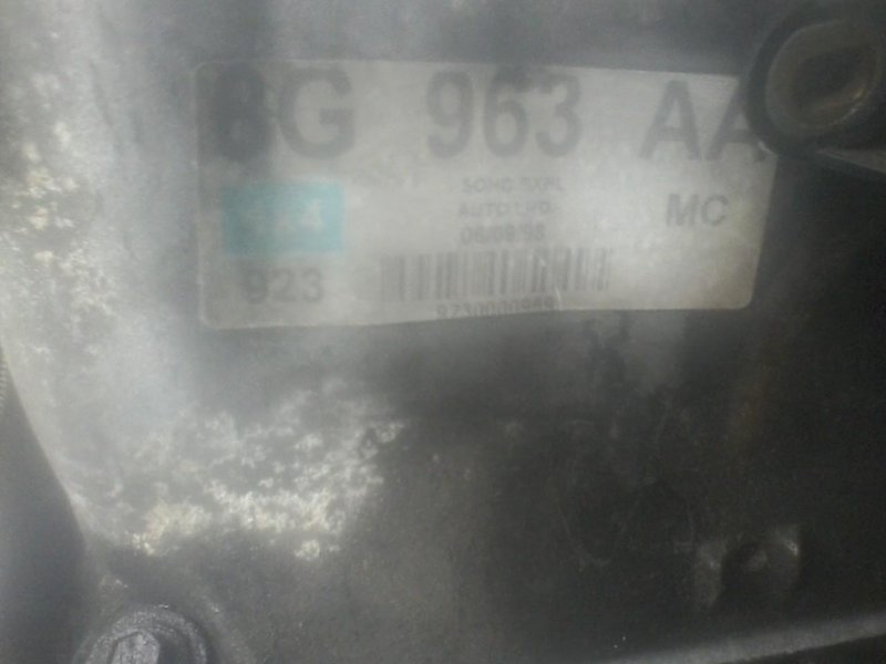

As I was installing the valve cover I noticed a sticker on it that says 4x4. Now I am pretty sure that this is the original engine. Everyone has been saying that balance shaft engines were for the 4x4s. I bet the factory ran out of the 2WD version of this 4.0 SOHC and put these in, in their place. In the blue area of the sticker you can barely see 4x4.
As I have said, my 2001 2WD Sport Trac 4.0L SOHC engine has the balance shaft. I do not plan to reconnect it. IDK if this is the original engine to my truck, but when I pulled the engine out I saw no indication that anyone had ever pulled the engine in the past. I had the same thought, that maybe Ford ran out of non-balance shaft engines on a given day and used the 4x4 engines instead.
If you removed your front timing cover it would have been obvious if you have a balance shaft. There would have been a chain, a guide and a tensioner coming off the crank shaft going to the right lower side of the front of the engine where the balancer shaft gear would be driven.

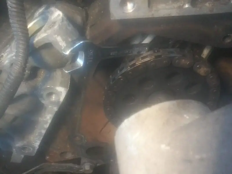

I was able to tighten the tensioner guide bolt that is located inside of the timing cover behind the top gear attached to the jackshaft. I didn't have a 1/4" swivel if that would have even worked to tighten it. I was able to lightly hammer a double open end wrench onto the head of the bolt. It is a 10mm bolt head but I couldn't get good leverage with a 10mm wrench. The 3/8" end of the DOE drove on nice and tight an then I was able to get enough pounds on the bolt that it won't come a loose.

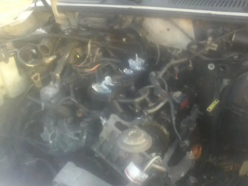

2nd photo: do you have the square harness tucked in correctly? I can't remember if that goes behind the bracket or underneath?
@drdoom I think that I have it routed correctly. It seems like there is only enough room behind the PS/AC bracket for the EGR bracket and the square harness goes below it. I have a double ended vacuum harness dangling that I think goes to the bottom of the upper intake. It will have to be disconnected and routed around the top and left of the engine.to be correct. The little harness with the bracket with 2 holes made to it is fastened to two timing cover studs on the RH side of the timing cover.
