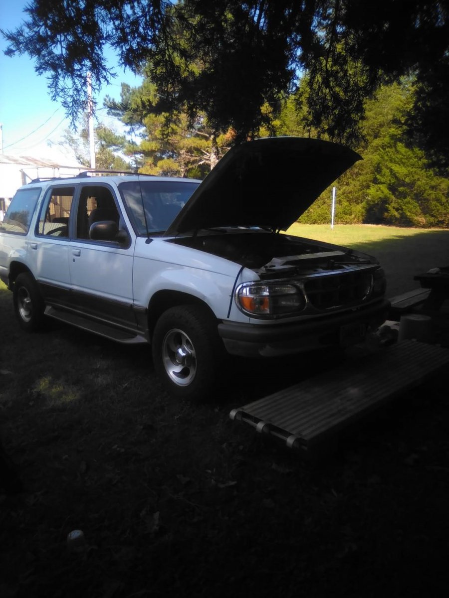

Saturday after my wife got home, just after I was wondering if something happened to her, at supper she told me about a slapping noise under the hood but it went away. I couldn't finish supper first. I had to go outside and open the hood and the good but used serpentine belt was missing two ribs. These 4.0 SOHCs are more difficult to put a belt on than the 5.0s. When I saw rubber and cord wrapped around the fan blade shaft and the upper slick idler, I knew that I was going to need to pull the radiator again. That will be the 4th time since early April. The slick idle which turns backwards would wiggle and when I got it apart, I could feel catchy spots when rotating the bearing. Catchy enough that it broke the RH thread bolt a loose. It seems that from a design standpoint that if something is going to rotate counter clockwise then a LH thread bolt would be a better choice. But anyway, after going to the shop to get one of the 86.5 long belts, I'm thinking to myself, where is a good idler? It turned out that the yellow 2002 Sport Trac has a 4.0 too. I went over to it and was able to check it out and it was good. It didn't take long to get it all back together and I didn't have an antifreeze mess because I'm still running water after having it apart several months earlier. Just a few minutes ago, I topped off the radiator, I took one more quart after a 1/2-mile test drive, enough for the thermostat to open. I'm glad that we didn't have an idler failure on the Florida trip or halfway in between on my wife's 4 days a week, 65 mile round-trip each day. I have installed a RH spindle in her work parking lot before. I think that she has put close to 60,000 miles on the truck since the left side cylinder head repair. I meant to check the mileage when I was around it.
Shredded belt pictured below. I put it in the garbage can instead of my work truck. In an emergency, the shredded part could have been cut off to get the truck to a safe place.

Sunday, I swapped the 2002 yellow Sport Trac radiator, fan shroud and lower hose into the '97 white 4.0 SOHC 4dr. I had the radiator out 4 times since April. One time I noticed that someone had glued a crack in the side that happened when the right front corner was hit by an uninsured white tail while the PO was driving. It was starting to seep a bit or more. All is well with it now, and 2.5 gallons of straight antifreeze put in.
