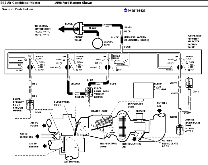

As far as I know, the vac lines determine where the air comes out (and in), but the electrically powered Blend Door Actuator determines the hot/cold mix.
Member GTMountain recently posted a diagram that could be useful:

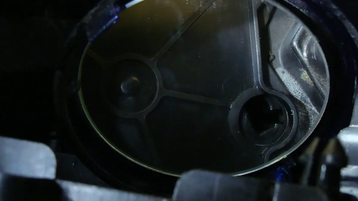

In my continuing diagnosis of the problem today, I think I found the issue: a broken blend door. With the actuator out of the way, I stuck a mirror up where actuator would be, at an angle, so I could see down where the actuator shaft goes into the axle that controls the door. Looks broken to me.

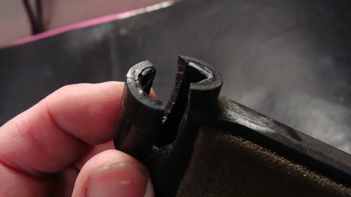

The hardest part of the job was propping myself up in a position to work under the passenger side dash! Hurtin' a bit today! So, I did as Spuddy suggested and cut further than the instructions said and cut the bottom shaft socket out too. The busted door fell right out, and there was plenty of tape with the kit to put the cut out piece (lower pivot socket included) to secure it back in place. In hindsight, I might've been able to do it without cutting out the socket. Problem is, it seemed to me you had to make the cutting decision beforehand, because deciding to cut the socket out by itself AFTER making the initial pie shaped cut, as the directions show, would make taping in the socket by itself tough.
Cut out piece ready for reinstallation.

In hindsight, I might've been able to do it without cutting out the socket... Problem is, it seemed to me you had to make the cutting decision beforehand, because deciding to cut the socket out by itself AFTER making the initial pie shaped cut, as the directions show, would make taping in the socket by itself tough.
Yeah, that's what happened to me, and what was just about to happen to you as well...
For me and you, it was not a decision but a necessity. When the top splits (mine failure looks almost identical - imagine that), if the socket remains attached to the plenum, the unbroken half of of the shaft from coming out of the upper socket and the door will not come out.
And, yes, then you have to cut the bottom socket out, and now the angles get really wonky while trying to put 'er back together.
