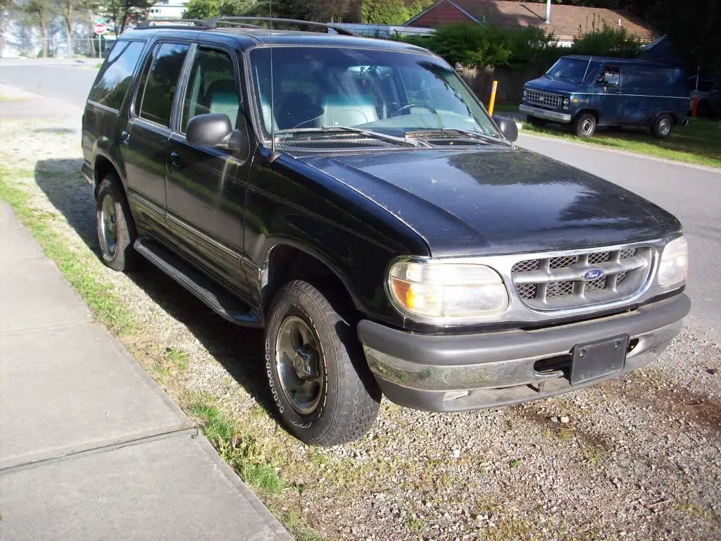

[ATTACH=full]227944[/ATTACH]
[ATTACH=full]227945[/ATTACH]
EUREKA! IT WORKS!

Also I just tried Rislone engine additive in the # 1 cyl. and it went up to 156 psi. from 58 psi. This forces me to try another.
Finally after a lot of wasted time and energy I have my motor out. Tomorrow I will put it on the engine stand and begin to tear it down. It is a 4 wheel drive so it has a few more bellhousing bolts than Streetrod2000's 2 wheel drive. All is well. More later on the stuck ring situation.
