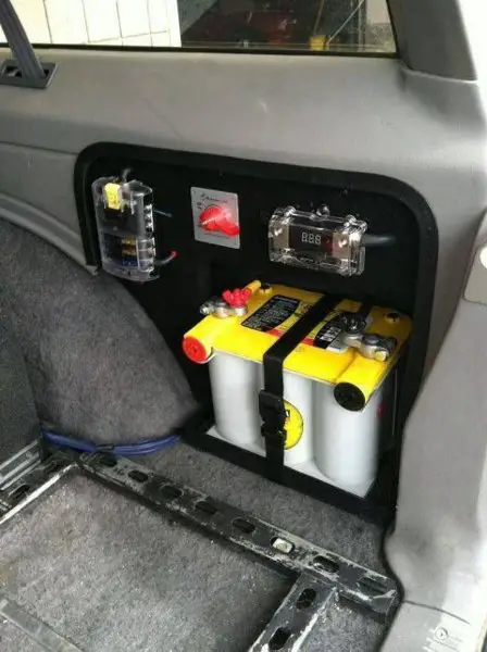

Ive also been looking to install a second auxiliary battery for charging misc accessories while on longer trips but wanted it tied into the alternator for obvious reasons. Im not set on the battery being in the engine compartment but I would love to see a few ideas on how others have done this type of setup.
I have seen a few setup inside the stock jack location on other model vehicles. This is what I was leaning towards and converting into a charging station for my laptop and cameras ect.

This is actually pretty close to what I was thinking about doing...
