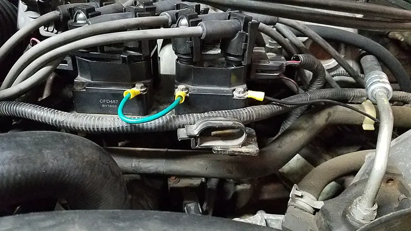

Move that ground to the metal bracket the packs bolt too, at the front remove that black plastic clip and hook it there , remove the jumper between packs as not needed, bigger wire if possible and test again ;)
You do realize that the top of the coil packs (where I have those wires jumping) are a ground right? The top of the pack where the bolt mounts too has a metal plate under it that is a common ground. By running a direct ground from the Drivers side to the battery, and then adding the jumper between packs I was able to see if it was just one pack with a bad ground or both. I want to say that there was a slight change in adding those wires, but it might just be wishful thinking on my part.
I did add an additional large wire (Spare battery cable, ground all the paint under the bracket so we have a good connection) as suggested just to see if it did anything for me. No change:
At this point the only way this thing can be more grounded is if I drive a copper rod into the Earth :) So it looks like it is time to tear into the harness, or throw a Crank sensor at it just for a whim.
