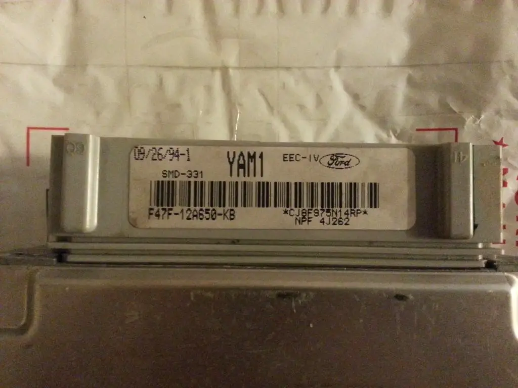

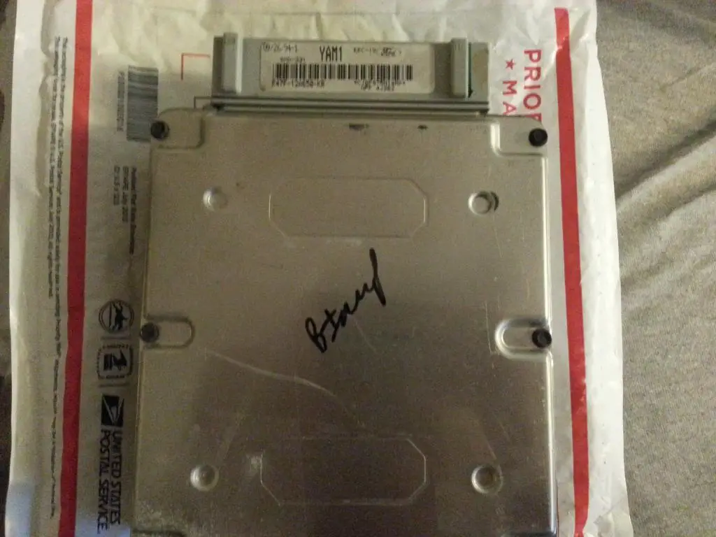

Here is the 94 explorer YAM1 ecm if anyone is interested
