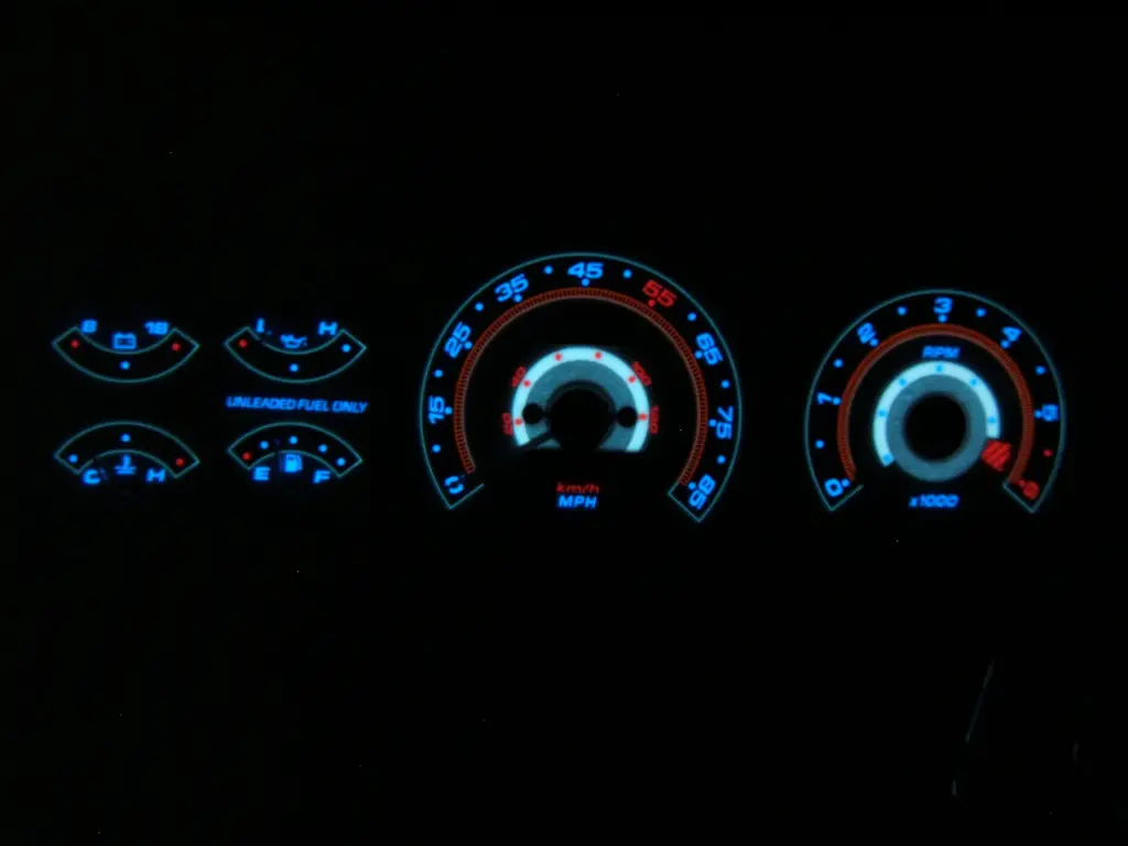

this is my write up on my 1st gen glo gauges i figured some one would have done this before but after i installed them and searched i came up with nothing so here it is.this is the set i used from ebay for $30 he also carries the ac and some other gauges.these things were a piece of cake to put in,didnt take more than 30 min and they look great.they are white at day and can be changed from blue to green and have a dimmer,witch you might have to use because they are really bright.

these pic were taken with it getting dark out so they are not the best

put your molding back on and the two screws for the ashtray and turn your lights on and make sure your dimmer for you headlamps are all the way up then adjust the dimmer on the new switch to the brightness you want and if you want green or blue and your done no more dim dash or hard to see numbers,i love this mod its one you will see every day!!
couldn't get a good pic of the different colors but it bright and clear!!!!
