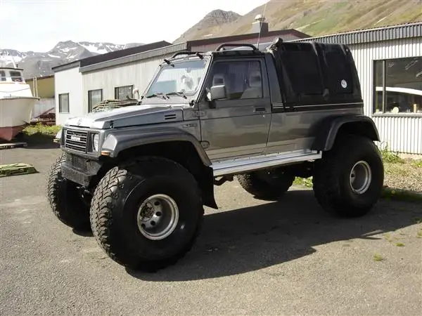

this is the car

Do you live in Iceland?
Nice rig!!
