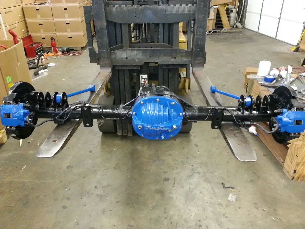

It will be a highway but I still wanna have my use of AWD and I will be doing a 4" suspension lift and not sure which tires and rims yet
Your awd will work no matter what rear end or gear ratios..
If you plan on a suspension lift then dont even worry about the bars..id wait to pick a gear ratio till you know your planned tires size and being you said highway i wouldnt go crazy with the gears..
That's terrible luck. I've never seen a V8 with anything but a D4. Should open up easier locker options, though.
