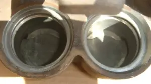

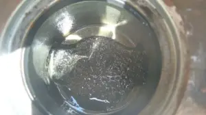

well first off I'm new to this forum and I found it because of course I now own an explorer yeah!! Big ups the the creator of this forum and every single member. Any way as the title states I have an issue going on with my wheels and a grinding noise. Well to begin, when I purchased the truck I realized that it will be needed brake soon. I drove for about a week tops with no issues until I heard a sqeaking noise so I proceeded to purchase brake pads. The same day I purchased the pads the explorer began to make an ugly grinding noise. So that's when I parked it and went to purchase some rotors. The next night after work I started to replace the old rotors and brake pads with the new ones. I also went ahead and replaced the inner and outer bearings. Now that I did the whole job I noticed that the grinding noise was still there not only that but like a scraping noise as well. I looked it up and found that the brakes need to be "broken" in so I did the 30/30/30 rule but, I still manage to hear the grinding and scraping. So upon more reasearch I found that the backing plate might be bent so I tried straightening it out and even removing the shield itself but yet the grinding and scraping noise is still there. Another thing I also noticed, is that when I tightened the wheel hub nut? The wheel on the drivers side moves freely but the wheel on the passenger side does not move at all when tightened all the way which is very odd to me. There is no play at all when I jack up the car and shake the wheel other then the passenger side due to having a bad upper control arm bushing which is getting replaced. Another thing I did is I thought I might(if possible) of put the pads on backwards so I switched them and yet I still here the grinding and scraping noise. Can it be my pistons are bad? Could it be a worped rotor?(which I doubt because I replaced everything and the noise was before and after) this is so mind blowing to me. It could be something easy. I checked all the brake clips and check the rotor but there is no sign of wear on the rotor. Ive been driving my explorer for two days like this and I'm not sure if it's dangerous or not because the brakes actually work real well.
I think that's everything that I did. I hope I explained enough if anybody needs any more info just please ask me.
It's a 2000 explorer xlt sohc 4.0 2wd
160k
160k
