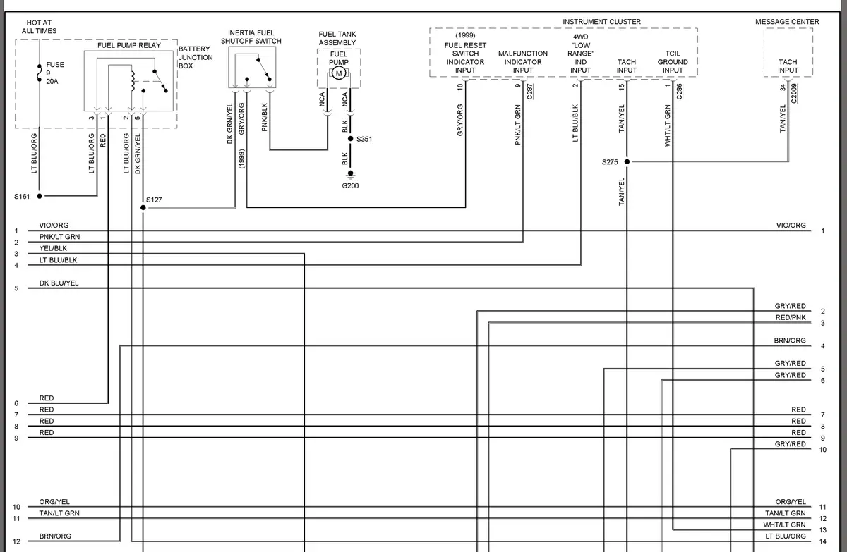

If you don't have any data, then you'd put the meter into voltage 20VDC (or nearest higher range) mode, put negative meter lead on any ground (chassis or battery negative terminal) and probe positive lead in the relay sockets to find which one is 12V (or 14.4V, etc, at the battery/charge system voltage) live. When the relay is energized, that will switch that 12V to another contact going out to the fuel pump. The other two used contacts are power to energize the relay and the ground to complete that electromagnet coil inside that trips the relay.
I looked at a wiring diagram for a 2000 but can only assume the wire colors are correct as follows. The relay itself may also have its contacts marked on the side as to their function and/or numbered on the bottom:
Relay pin 1: Red wire, half of coil
Relay pin 2: Light Blue/Orange, other half of coil
Relay pin 3: Light Blue/Orange, power input
Relay pin 4: Not used, there may not even be a contact for it in the relay socket
Relay pin 5: Dark Green/Yellow, power output
I don't know how they have the coil wired. Either one of the two is always live voltage, or one of the two is always grounded, but without the key turned to turn the pump on, you won't have both live voltage and live ground on the coil, but when the fuel pump should be running, first couple seconds with key in aux position or while cranking engine, you should have both live voltage and ground on the coil, then 12V+ on the power output, and at the pump connector plug.
While you can use the multimeter to probe for the power input on the socket contact that corresponds to relay pin 3, but you'd have the relay unplugged and obviously it won't complete the circuit unplugged so there isn't going to be output on the socket contact for pin 5 without the relay plugged in.
If there's power input and coil power and ground, you can presume there will be power output on pin 5 when using a known good relay, and it then follows that you "should" have power on the wire going all the way to the pump connector once the relay is plugged back in, if the circuit is good so far, and then if pump gets power and ground but doesn't spin, it's bad.
Now suppose you had no coil circuit completion, either no power or ground to that part of the relay, then using a jumper wire between the relay socket pin 3 and 5 should turn the pump on if it's good. I mean, odds are only one thing has failed... unless you're cursed. :eek:

According to the wiring diagram I see, if the inertia switch has tripped, it should cause a dash "fuel reset switch indicator".
You can probe with a multimeter for 12V between the input lead to the inertia switch and (chassis) ground, when the pump is supposed to be actively pumping, to confirm power is getting to it. You can probe for 12V between the inertia switch output and ground, to confirm it's making a closed circuit (working), though you could instead just do a continuity or resistance test between the input and output pins of the switch to confirm it's working.
However, if the inertia switch trips, it does not reset itself without being pressed, so it is not likely the problem since the vehicle has failed to start but sometimes does start, correct? If it ever starts without having had the switch manually reset, then it did not trip. There is a slim chance that the contacts at the switch, as anywhere else, could be corroded and making intermittent contact, but not likely considering this is an interior component (located at passenger foot well panel, IIRC?) , nowhere near as likely to corrode first unless the vehicle found its way into a lake or otherwise submerged interior.
Anyway, on the wiring diagram I'm looking at, the inertia switch has dark green/yellow input (should read 12V when fuel pump should be on), and pink /black output to fuel pump, which also should read 12V relative to ground when fuel pump should be on. If you are reading 12V on the output, but are not getting pressure at the fuel rail check valve, then either you have a fuel rail clog (fuel filter most likely) or more likely still is it seems to be time to pull the tank off with the assumption that the pump has failed or at least the electrical connection to it.
If you get this far to the point of feeling you need to pull the tank then you can inspect the connection, measure for 12V at the connector when the pump should be running, and even apply 12V direct to the pump motor with a jumper from the battery to see if it works.
