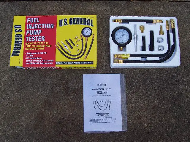

OK so I also decided to check the fuel pressure before and after the change to see if there was a difference. SO before the change the pressure was between 25 and 30 at idle .. say 27, and after it was .... wait for it ... 27 at idle. Which seems really low. SO I repositioned the gauge and revved the engine to see what the pressure did ... it dropped in the high 20's say 21 when I revved the engine... Sounds like I need a new fuel pump?
I tested using the best tools harbor freight could provide, and I connected to the port near the front of the engine on the passenger side of the engine on the fuel rail. If I remember right the pressure can start in the 30's but is supposed to climb when the engine is revved or put under load is that right?
This thread says I should start in the 30's and go up to the 60's
http://www.explorerforum.com/forums/showthread.php?p=2359055
your fuel pressure is way to low. for a 2000 model (return-less system) you should be around 65-67 psi.

Harbor Freight tester
I had problems getting an accurate pressure reading using Harbor Freight's fuel injection pump tester.
The fitting on the test adapter did not depress the Schrader valve core adequately. I had to remove the valve core to get an accurate reading. If your readings are accurate, then I agree with koda2000 that your fuel pressure is very low. My 2000 Explorer shop manual states that the fuel pressure for the returnless system should be 65 psi +/- 8 psi. My stock pump pressure was about 62 psi and did not vary with engine speed. The fuel pressure regulator (FPR) is part of the fuel pump assembly and is about midway in the photo below.
Sometimes the hose above the FPR will rupture causing loss of pressure. It is often not replaced when the fuel pump is replaced. The dealer technician who replaced your pump may have bent the float arm when removing/installing the assembly causing the incorrect reading. Or the sliding contact material may just be worn off with age.
Very good information,
I will retest tomorrow without the schrader valve just to be certain. (My gauge is the exact same as yours) I am suspicious of the gauge because it is running so well with so low of pressure.

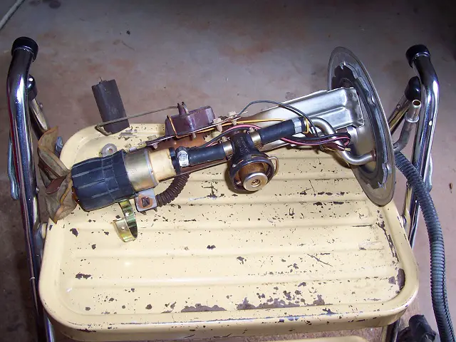

FPR = fuel pressure regulator. in the pic provided by streetrod2000, it's the round thing half way up the fuel pump assembly. it is mechanical and dumps excess fuel pressure back into the tank. if it goes bad it might release pressure too soon. also notice the rubber hoses between the fuel pump before and after the FPR. if the clamps are loose or if the hose splits you will lose fuel pressure. the issue with your fuel gauge was probably due to a bend rod on the float. that has nothing to do with the fuel supply. if you find the pump is the issue, you can replace just the pump (not the whole assembly) for under $100. Bosch makes a good pump.
BTW, any leaking would be internal/inside the fuel tank, so you wouldn't see anything. and before you do anything else, remove the schrader valve from the fuel rail connector and retest the fuel pressure.

I realize I was supposed to remove the Schrader valve (for further diagnostics), before I removed the pump, but I had the part and I felt like doing it so I did. I purchased the entire assembly because I did not want anything else to break. First thing I did was remove the filter on the engine side and looked at the fuel output while starting the engine. The stream was very small with little force, think old man with prostate issues urine stream.
So I dropped the tank and I noticed the Vapor return valve was broken, I don't think I broke it, but it is possible. I got a replacement return valve and put the new pump assembly on and put it back on. Check the fuel coming out of the fuel filter and it is much better. Think race horse after a keg of beer.
Get everything hooked back up, and the truck is running ... awful. Blowing black smoke, and stumbling. I figure the computer is trying to relearn the new pump, so I reset the computer by removing the battery cable, it helps but not much. I disconnect the MAF, and tada! the truck runs like new. There is a slight hesitation when fuel is applied, but it is running better than ever. (20+ MPG)
My conclusion. MAF and Fuel pump, or fuel regulator (replaced the entire assembly) are causing my problems. The fuel pump could not keep up with demand, and when it could the MAF tried to drowned the engine. Perhaps the fuel regulator was a party as well. Not sure if the vapor return might have been causing issues as well.
