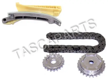

According to Tasca Ford the new OEM left cassette shown below is compatible with the 2005 thru 2007 Mustang.
It appears to be identical to the cassette installed in the 2002 and later Explorers. The traction and slack sides of the guide assembly are reinforced with metal.

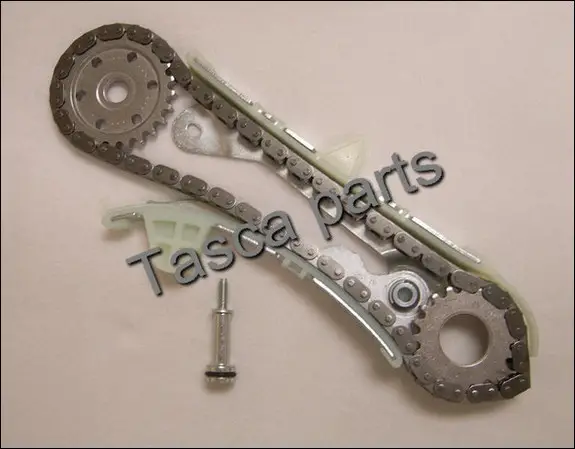

The Tasca Ford new OEM right cassette shown below is compatible with the 2005 thru 2010 Mustang.
It appears to be identical to the cassette installed in the 2002 and later Explorers. The slack side of the guide assembly is reinforced with metal but the traction side is not. The traction side can break apart due to fatigue just like on the 1997 and later Explorers.
