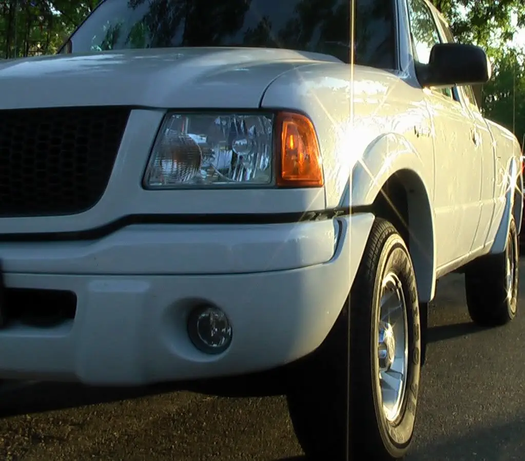

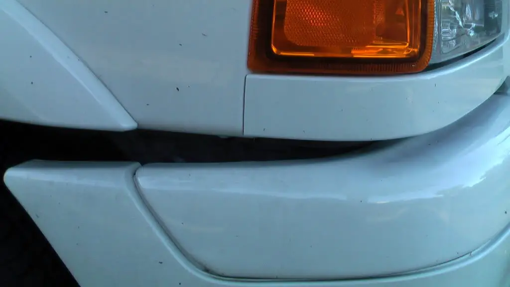

Hello! Long story short when I was walking to my truck that was parked in a parking lot I noticed something very strange about my bumper.... I have never noticed it until that day and I am pretty sure someone hit my bumper and took off without leaving me a note. On the left side front bumper it is shifted down and pressed in. However, on the right side its not shifted and has a gap how it should be.
Here are a few pics just to show you what it looks like.
Left side bumper (The part that shifted down and is pressed in)

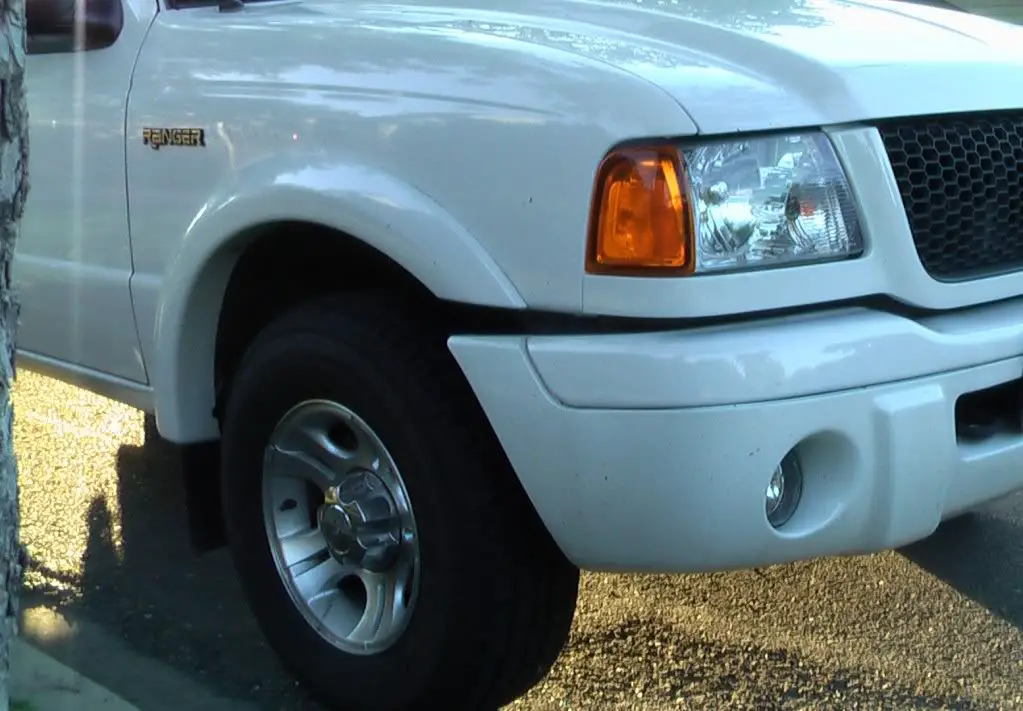

And here is the right side how it should be
Can one please give me any information how I can fix my bumper? I have no idea what to do.... Should I try to fix it myself along with a friend? Or should I cough out the extra money to take it into a auto shop?
Does it look like I need a new bracket or anything else? or does it look like I can push it back up????
I really need some help and I would really appreciate it!

Crawl under your truck bumper.Look for the bolts that mount it to the frame.Loosen them,and use a jack to jack the bumper back in place,then retighten the bolts.It is that simple.
I took a look at the brackets and they are welded on to the frame of my truck.... So taking a look at the big pic it would cost me a ton of money just to take it to a shop... So I put some thought into it and came to the conclusion if I put enough pressure on the bracket I can bend it back to place....
I couldnt loosen/tighten the bolts since they where welded on... Dont ask me why I have no idea....
So I lifted my truck up at my friends shop and put a bar underneath the bracket and slowly lowered the truck!
With about 5 attempts my bumper looks brand new!
Just had to bend the brackets back to place....
And someone mustve hit my truck pretty hard because the bracket was bent pretty darn bad :mad:
But yeah it looks good now!
Thanks yall
