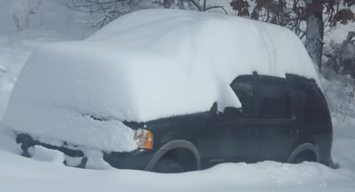

With the engine down in my basement for the winter, and the Explorer snowed in,
there is time to figure out what to do next.
