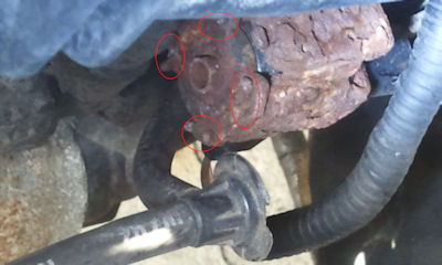

I looked everywhere on the internet to show exactly where this part was located to no avail...
I drove to my local dealership and they pointed it out to me right away along with the vacuum lines that just fell off the module...
The module is made of metal and plastic with one (1) electrical connectors on the bottom and on the back and two (2) vacuum lines connected by a plastic connector on the front of the module connected to the IMRC by crimped metal tabs on the metal housing of the module...
The metal component of the IMRC has rusted considerably and the plastic housing that the vacuum lines connect to were crimped to the metal housing.
So, when the metal housing rusted away the crimped metal holding the plastic part that the vacuum lines connect to failed and fell off.
Below is an actual photo of the rusted part and the vacuum lines that fell off.
The metal crimped areas are circled in red...

AND upon further inspection of the old part and the new part, the plastic piece where the vacuum hoses were attached was NOT held on by crimped metal tabs. The crimped metal tabs were holding on the metal end which held the plastic piece in place. The plastic piece that the vacuum hoses were attached to was broke at the top and bottom. (The only places it could break.) Very bad design in my opinion.
In my opinion the cause for the plastic piece to fail was because of the rust. The rust expanded and caused the plastic to fail and break from stress.
Here is two images of the old rusted, broken IMRC after removal.
You can clearly see in the images below where the plastic failed and broke. Circled in red.
CLICK IMAGE FOR LARGER IMAGE
You can also see how the rust built up and expanded and obviously caused the part to fail.
