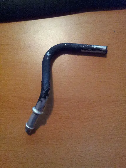

Hey there,
I was trying to find a power steering leak and I replaced the hose but I noticed the line going into the Rack was cracked before fixing the hose too. Well low and behold when removing the hose the aluminum line came off too. Is this part 3A713B?
Also since ALLDATA doesn't quite show this. How is it attached to the Rack? Is it just threaded in? It is sheered right at the rack so I am not sure how I am going to get it out.

Now anyone have any good tips on how to get that sheered line off? How is it connected to the rack? I took the nut off to the right of the hose. Ford dealer said they have literally no clue when they could order it in and it's $50. I can't be down a truck that long!
Anyone know what to do? You can't order the part from Ford and no 3rd party sells it. What models have this same Rack?
To remove the remaining piece of the line, you have to remove the clamp that is holding it on
The replacement part 3A713B is ford # 6L5Z3A713H which is available from all OEM Ford part dealers for around $13 - $20
Got it out! I managed to find one on Ebay. It claims to have low stock too so we will see if he actually has it or not. Now I need to find the Pressure Lines too. Seems like all the major Sites have the wrong lines (Rock Auto, Autozone, Advanced.. etc) They all seem to have ones that threaded into the rack and not held on by that bracket.
