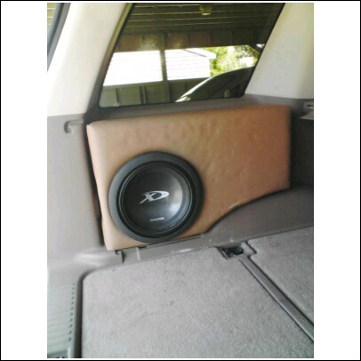

i dont think there is enough room in there for a 10 or 12. you can always make your own box and put it in the same location, but on the drivers side. here is a pic of mine.

Can't do that. I have the rear AC so no drivers side storage. Your box looks good though.
You could try something that likes a very small sealed enclosure, like a Boston Acoustics G3-10" (.5 cu ft) or G108 8" .3 cuft (or even two)....the 8" still has plenty to offer a regular vehicle. No, it won't set off alarms 9 blocks away, but plenty capable...
