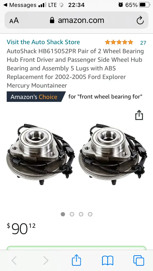

Something front Amazon waiting on a day off to install. There is no axle nut or cv axle on the front. I thought blue and red was two lock tite options.
There are lot of colors available, but blue and red are the most prevalent, at least in my experience.

Auto shack no bolts or instructions
Called Autozone and asked about lock tite needed I was told no. I even mentioned to them my understanding that locktite is applied at factory. They replied factory applies lock tite to every bolt.
