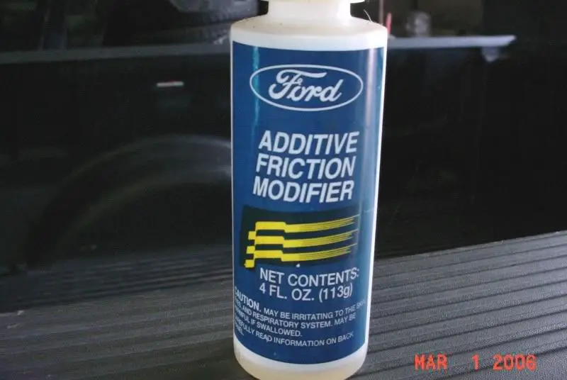

I'll go out on a limb here and call torque converteor the controls. Put a bottle of FORD LIMITED SLIP ADDITIVE in it and see what happens.(Yes, rear end additive)
I really hope that its not the Torque Converter, but I will be spending all weekend trying what ever I can to get it running back to normal. I just find it really strange that it ONLY does it after the motor is warm. No issues what so ever on a cold start?
