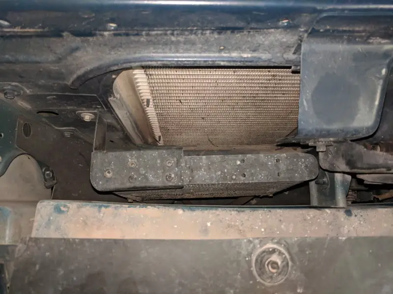

Has there ever been any discussion/comments/dialog regarding the stock location of the transmission cooler? I just recently noticed (despite having purchased it new... 85k miles now) that only about 40% of the cooler gets any ram air effect. About 60% is blocked by they way the grill is designed. I did have to swap out the valve body a coupla years ago which fixed the infamous 2-3 shift flair and I have not had any issues since.

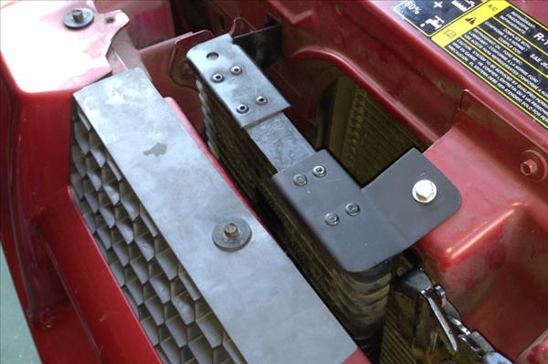

This mod took less than a day to complete and the only cost was a few feet of line.
Call me obsessive but I even went to the trouble to punch holes in the structure behind the upper grill in an attempt to eke out every last bit of ram air effect I could. Now probably 80-90% of the cooler gets ram air.
I mfgr'd both an upper and lower bracket designed to bring the cooler up so that the lowest plate was slightly above the lower grill opening.

Now here is the surprising part. Before I put a wrench to anything I took it on a 12 mile freeway run (two long hills) with O/D disengaged.
Then did the same trip after the mod the next day at the same ambient air temp. (80º). While a single run is less than scientific, here was the results, using a laser thermometer on the supply line right where it fastens to the transmission:
Before: 216º
After: 187º
That's darn near a 30º reduction.
Sure wish I would have done this the day after I bought it!

Where/how I relocated the original cooler.
The lower bracket is shown here.
A little overkill perhaps but I wanted to get every little bit of ram air on that cooler that I could.
Notice the holes I bored into that plate.
Another view.
