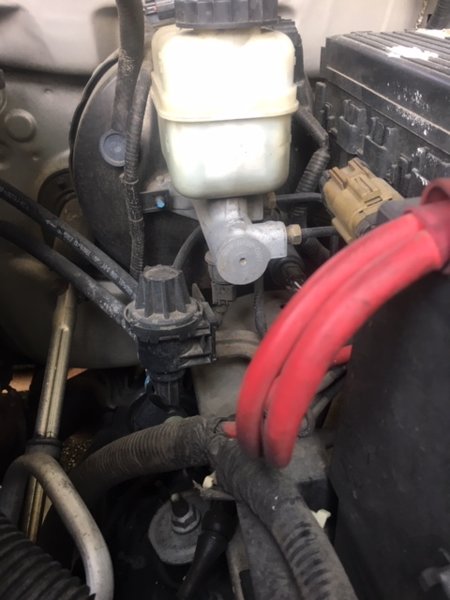

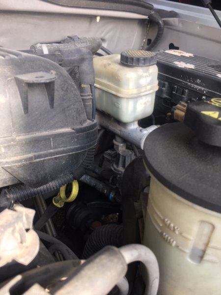

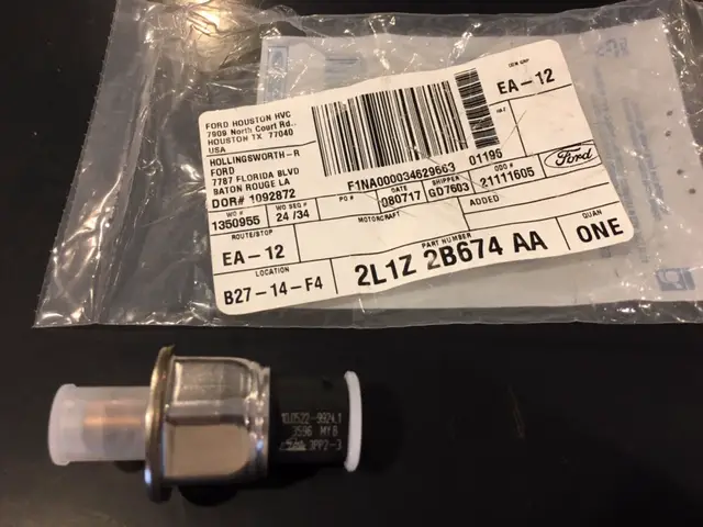

I have a new problem. My 2005 model doesn't have the switch that you mentioned. Numerous other folks on here also refer to this switch located on the master cylinder but there is something different about my SUV. I don't seem to have any sort of switch located on the master cylinder. Please take a look at the pictures I have posted. The only sensor of any kind mounted on my master cylinder is the one that is in the pictures. My local Ford dealership parts department claims the sensor that hangs down under my master cylinder is a hydraulic pressure transducer and, has something to do with the anti-lock brakes, and it costs $172. So, I am back to square one. Have you had any experience with 2005 models? Thanks in advance!
I don’t know if Ford changed the control circuit for 2005.
Here is mine, circled in red.
^^ That's the same setup my '04 has.
