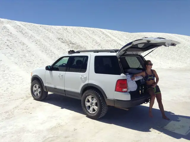

Hello everyone! Thanks in advance for the help and suggestions. I have a 2005 Explorer XLT with just at 100,000 miles on it. I have owned the truck for 7 years now and it has been a great vehicle. I have the 4.0 SOHC V6 and 2WD platform and I am always impressed with where this conglomerate of steel and rubber can go. If it's dry, I can usually get through or up whatever I need. This thing has been to the top of several mountains and has towed thousands of pounds of wood and materials up trails that were daunting even without a trailer. I'm always impressed. Anyways, the truck is paid off and I've slowly (with the help of this forum) begun modifying my Exploder to make it something unique and more capable.
As of lately, my 5r55 has been acting up. Pretty normal stuff from searching through this forum. I'm right at the 100,000 mile mark when these things apparently start to fall apart. The larger 31'' BFG's, extensive trail time and heavy towing are sure to have fueled the fire. Oh well. My latest project for the Exploder is doing a 5-speed transmission swap with the M5OD. Before anyone says, "just repair the 5r55 or swapping in another auto is easier.." just hold the phone because that is not the direction I want to go. The 5speed swap will be more time consuming and expensive and I understand that. I also believe that the results will justify the work and the price tag.
