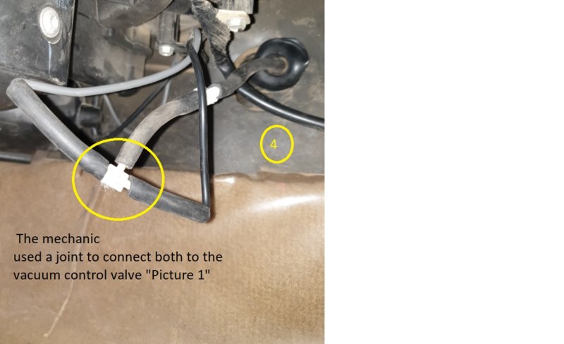

Picture 1 the valve

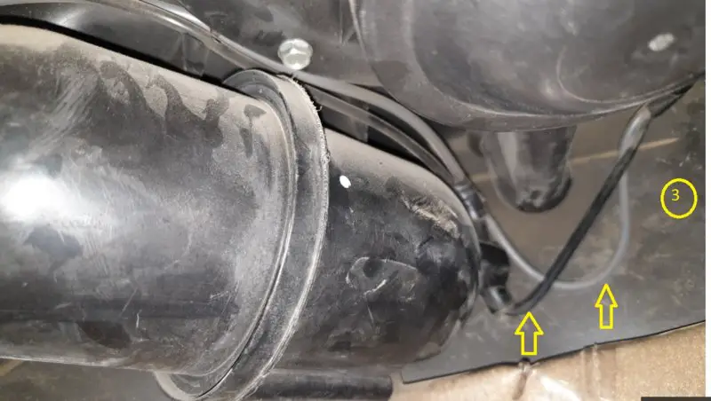

Picture 2 : i think this is the part where the gray vacuum line should be connected

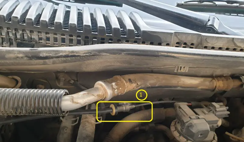

Picture 3 : the black and gray vacuum lines under the passenger side dashboard

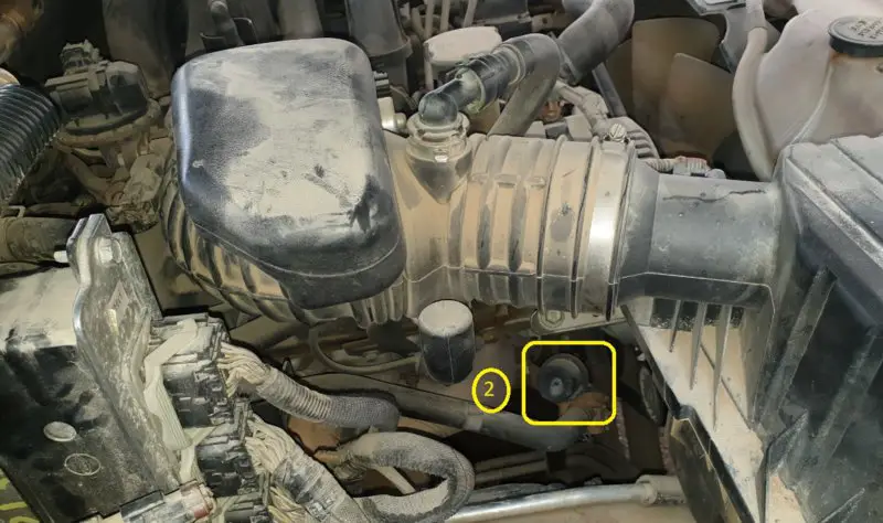

picture 4: they way the mechanic joint the two vacuum lines to the valve in picture 1
Need your support to figure out where i should connect the gray vacuum line, and if this joint will harm the AC
